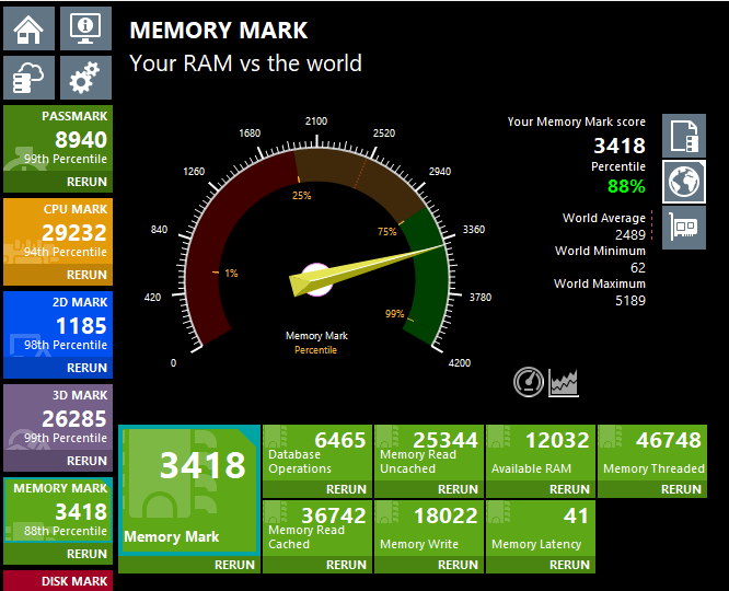

How are you guys checking the performance improvement of the RAM overclock? On a laptop is a lot harder because you can't change voltages, so everything needs to be very tight on the stock voltage, which is already quite low at 1.2V . The best I could do was to reach 3600Mhz CL20 on a stock 3200Mhz CL22, but couldn't manage to get CL19 to work. Now I'm curious to know which of the 2 would be the best: 3600CL20 or 3733CL22

Thanks! I think I'm not too bad, then:

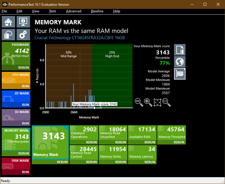

@FerrariVie - I was curious to see your Memory Mark scores there. So I went back to double check my RAM scores both Overclocked and Stock. I have a decent capacity advantage but I am still surprised at other scores where I beat your scores at everything other than latency and threaded operations.
What is your RAM as advertised and what have got it OC'd too? I would be interested to see your scores at stock settings as I wonder if your Overclock is not doing you that many favours?
Mine is 3000 MHz at CL16 stock (OC’d to 3200 CL16 - so the real latency is a good bit better than your 3200 CL20, but that doesn't seem to explain the big difference particularly when overclocked?
Here is mine at stock:
and Overclocked:

yours isn't too far behind my ram in all honesty... however, i flashed my bios earlier and i have only reset my timings, i need to do some more work on ram i think.

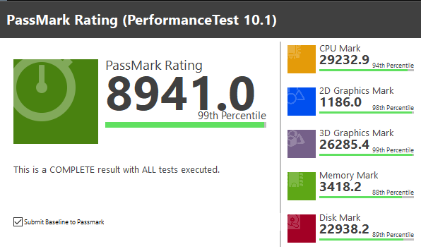

Super - so the capacity doesn't carry all that much weight in the scoring by the looks of it.
You have me whipped in Database Ops and Memory Write - but we are pretty close everywhere else really....
Look what you push me towards...
